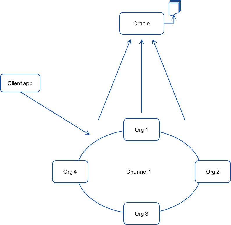

  • Introduce an oracle that smart contracts can invoke. In this model, the oracle is a trusted third party that answers questions in a deterministic fashion without knowing the full context of the transaction. In other words, privacy and confidentiality are preserved.
    Figure 2. Introduce a trusted oracle
    Smart contracts invoking a trusted oracle

The architecture for this scenario
The following diagram shows the architecture and sequence of events for leveraging an oracle component from a multi-participant blockchain network:
Figure 3. How an oracle component works with a blockchain network
In the above diagram:
  1. A client application submits the transaction to each organization that needs to endorse the transaction (as specified in the endorsement policy). The client application is completely unaware that the smart contract will delegate a portion of the execution to an external system.
  2. Each endorsing peer in each organization, in parallel, issues a request to the oracle with sufficient information so that the oracle can correlate the various requests from the different endorsing peers. This transaction structure shows a potential approach for doing so: The oracle can correlate the various requests from the different endorsing peers
    The transaction data structure above uses a Merkle tree that includes all inputs sent to the smart contract, though it exposes only those fields that must be shared with the oracle. Using a Merkle tree allows for traceability between the input parameters and the oracle’s response. Note that the binding field is used as a unique way to identify the transaction and the requester. Now, creating this linkage could be optional since the verification and execution phase in Hyperledger Fabric will address the case where a peer is compromised.
  3. The oracle uses the binding field (as shown in the diagram below) to correlate common requests and ensure consistency in the response. The response should also be signed by the oracle to avoid any potential tampering. Also, an Apache Kafka topic could be used to ensure ordering of those requests.
The oracle uses the binding field to correlate common requests
The oracle’s response structure could look like the one above, which includes a link between the request hash and the response, and also a signature from the oracle.
  1. The endorser peers validate the signature of the oracle. The signature and the response data should all be preserved on the ledger to provide auditability.
