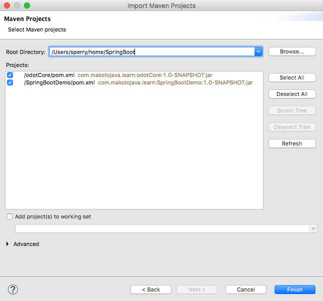

Now you’re ready to start working directly with Spring Boot. Examples in this section are based on a simple application called HelloSpringBoot. I encourage you to work through the application development example with me, but if you want to jump right in you can download the application code from Github.
Let’s dive right in and create a new Maven project!
Create the Maven project
In Eclipse, go to File > New Project and select Maven > Maven Project, as shown in Figure 1.
Figure 1. Selecting a Maven project
Screenshot of the Eclipse New Project dialog for selecting a Maven project.
Click Next, then click Next again on the dialog that follows (not shown).
You’ll be asked to choose the archetype of your new Maven project. Select maven-archetype-quickstart, as shown in Figure 2.
Figure 2. Selecting the Maven quickstart archetype
Screenshot of the New Project dialog for selecting the Maven quickstart archetype.
Click Next.
Finally, enter the artifact settings as shown in Figure 3.
Figure 3. Selecting the Maven artifact settings
Screenshot of the New Project dialog for selecting the Maven archetype settings.

Import the code into Eclipse
Go to File > Import… and choose Maven > Existing Maven Projects.
In the next dialog, use the Browse button to navigate to the root directory. Both of the projects cloned in the previous step should appear in the dialog, as shown here:
Figure 8. Import Maven Projects
Screenshot of the dialog: Import Maven Projects.
Click Finish to import the projects into your Eclipse workspace. Next you’ll build the executable JAR.
