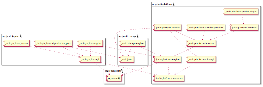

Figure 2 shows the dependencies among the various JUnit 5 packages.
Figure 2. JUnit 5 package diagram
An illustration of the JUnit 5 package diagram.

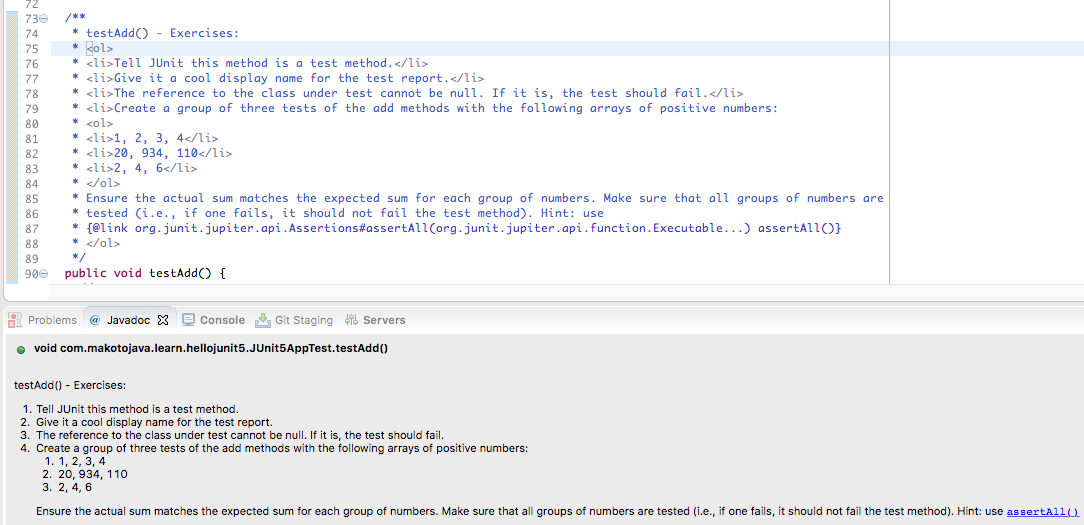

Write JUnit Jupiter unit tests
Start with JUnit5AppTest.java. Open this file and follow the directions in the Javadoc comments.
Hint: Use the Javadoc view in Eclipse to read the test instructions. To open the Javadoc view go to Window > Show View > Javadoc. You should see the Javadoc view. Depending on how you have your workspace setup, the window could appear in any number of places. In my workspace it looks like the screenshot in Figure 3, appearing just below the editor window, on the right-hand side of the IDE:
Figure 3. The Javadoc view
A screenshot of the Javadoc view.
The Javadoc comments with raw HTML markup are shown in the editor window, but in the Javadoc window they are formatted and much easier to read.
