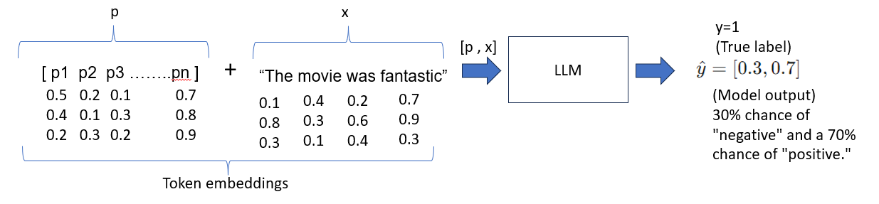

So, x′ = [p, x] = [p1, p2.., pn, "The movie was fantastic"]. The following figure shows our example (for illustration purposes only) with 3-dimensional token embeddings. Each word (or token) is represented by a set of numbers called "word embeddings" (in this example, it is 3-dimensional). For example, the token p1 is represented as [0.5 0.4 0.2], the word ‘movie’ is represented by [0.4 0.3 0.1], and so on.
3-dimensional token embeddings on model input
The true label y is explained in Step 2.
Step 2. Model operation
The LLM then processes this concatenated input x′ to produce output, ŷ:
Formula showing the LLM processing concatenated input x-prime to produce output y-hat
The result of which is [0.3,0.7].

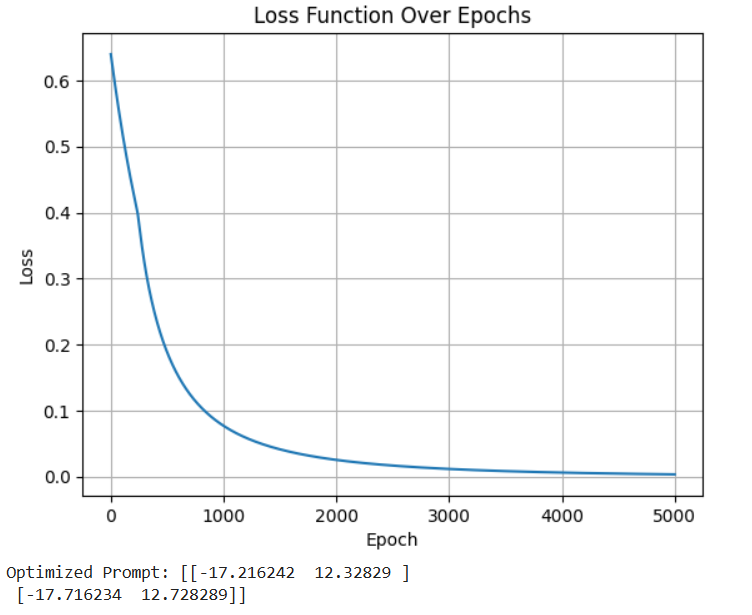

# Plot the loss values
plt.plot(loss_values)
plt.title('Loss Function Over Epochs')
plt.xlabel('Epoch')
plt.ylabel('Loss')
plt.grid(True)
plt.show()
print("Optimized Prompt:", prompt_embedding.numpy())
Output of our Python code
Here is the output of the Python code, the loss function and the optimized prompt.
Graph showing the loss function decreasing over epochs and the final optimized prompt values
