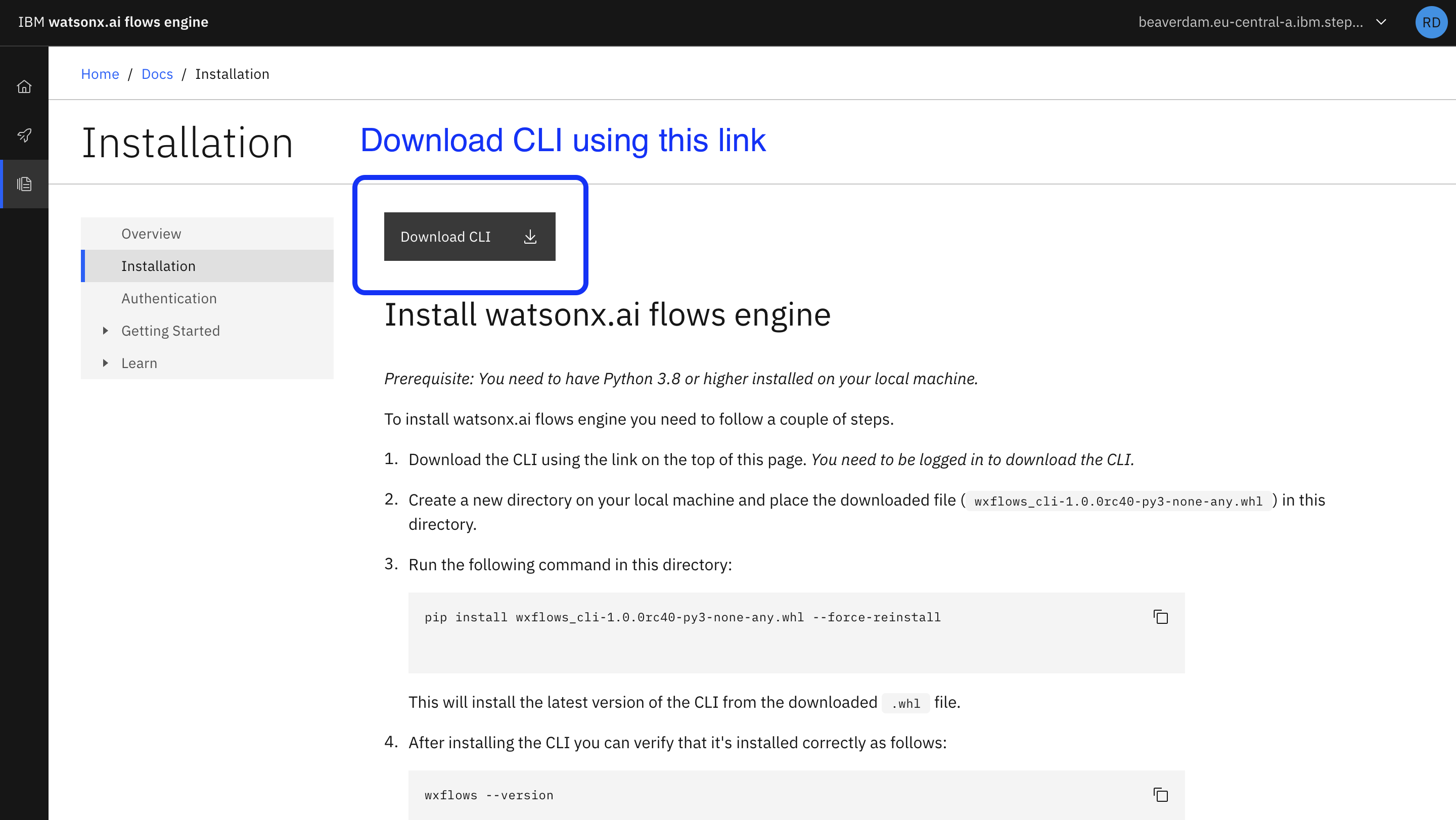

Download the CLI using the link on the top of the installation page. You need to be logged in to download the CLI.
watsonx.ai flows engine installation page
After downloading the file, you can place it inside your project directory and install the CLI using pip:
pip install <DOWNLOAD_FILENAME> --force-reinstall
Be sure to replace <DOWNLOAD_FILENAME> with the name of the file you downloaded. For example, if the file is called wxflows_cli-1.0.0rc40-py3-none-any.whl you need to run the command pip install wxflows_cli-1.0.0rc40-py3-none-any.whl --force-reinstall.
