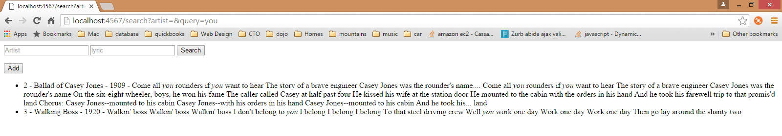

The app’s index page showcases the Java client’s capabilities:
Scheenshot of search results
The UI:
  • Renders the list of existing songs
  • Offers a button to add a song
  • Makes it possible to search by artist and lyric
  • Returns results with matches highlighted

Advanced querying and match highlighting
To support more-advanced querying and match highlighting, use /search as shown here:
Listing 7. Searching and highlighting
Spark.get("/search", (request, response) ‑> {
        SearchRequestBuilder srb = client.prepareSearch("music").setTypes("lyrics");
        String lyricParam = request.queryParams("query");
        QueryBuilder lyricQuery = null;
        if (lyricParam != null && lyricParam.trim().length() > 0){
            lyricQuery = QueryBuilders.matchQuery("lyrics", lyricParam);
        String artistParam = request.queryParams("artist");
        QueryBuilder artistQuery = null;
        if (artistParam != null && artistParam.trim().length() > 0){
          artistQuery = QueryBuilders.matchQuery("artist", artistParam);
        if (lyricQuery != null && artistQuery == null){
          srb.setQuery(lyricQuery).addHighlightedField("lyrics", 0, 0);
        } else if (lyricQuery == null && artistQuery != null){
          srb.setQuery(artistQuery);
        } else if (lyricQuery != null && artistQuery != null){
          srb.setQuery(QueryBuilders.andQuery(artistQuery,
              lyricQuery)).addHighlightedField("lyrics", 0, 0);
        SearchResponse searchResponse = srb.execute().actionGet();
SearchHit[] hits = searchResponse.getHits().getHits();
    Map<String, Object> attributes = new HashMap<>();
    attributes.put("songs", hits);
    return new ModelAndView(attributes, "index.mustache");
}, new MustacheTemplateEngine());
The first interesting API use to note in Listing 7 is QueryBuilders.matchQuery("lyrics", lyricParam);. This is where you set the query for the lyrics field. Also of note is QueryBuilders.andQuery(artistQuery, lyricQuery), which is how to join the artist and lyrics parts of the query together in an AND query.
The .addHighlightedField("lyrics", 0, 0); call tells Elasticsearch to generate a search-hit highlight result on the lyrics field. The second and third parameters specify unlimited size fragments and an unlimited number of fragments, in that order.
When the search results are rendered, place the highlight results into the HTML. Elasticsearch is kind enough to generate valid HTML that uses <em> tags to highlight where the matching strings occur.
