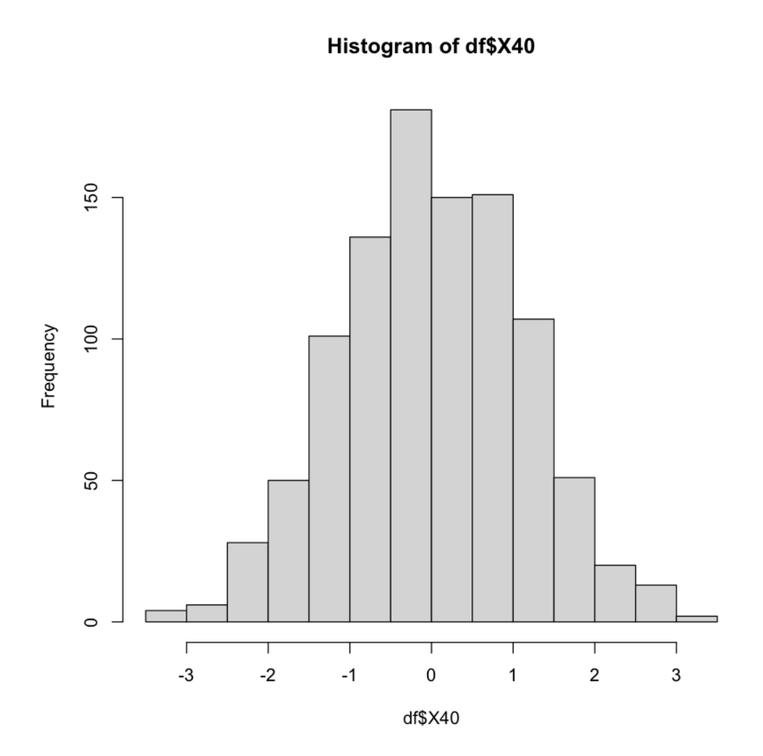

Next, let’s create a histogram to visualize the distribution of one of our features. This can be done quickly with R’s hist() function. As you can see, this feature is clearly normally distributed:
hist(df$X40)
